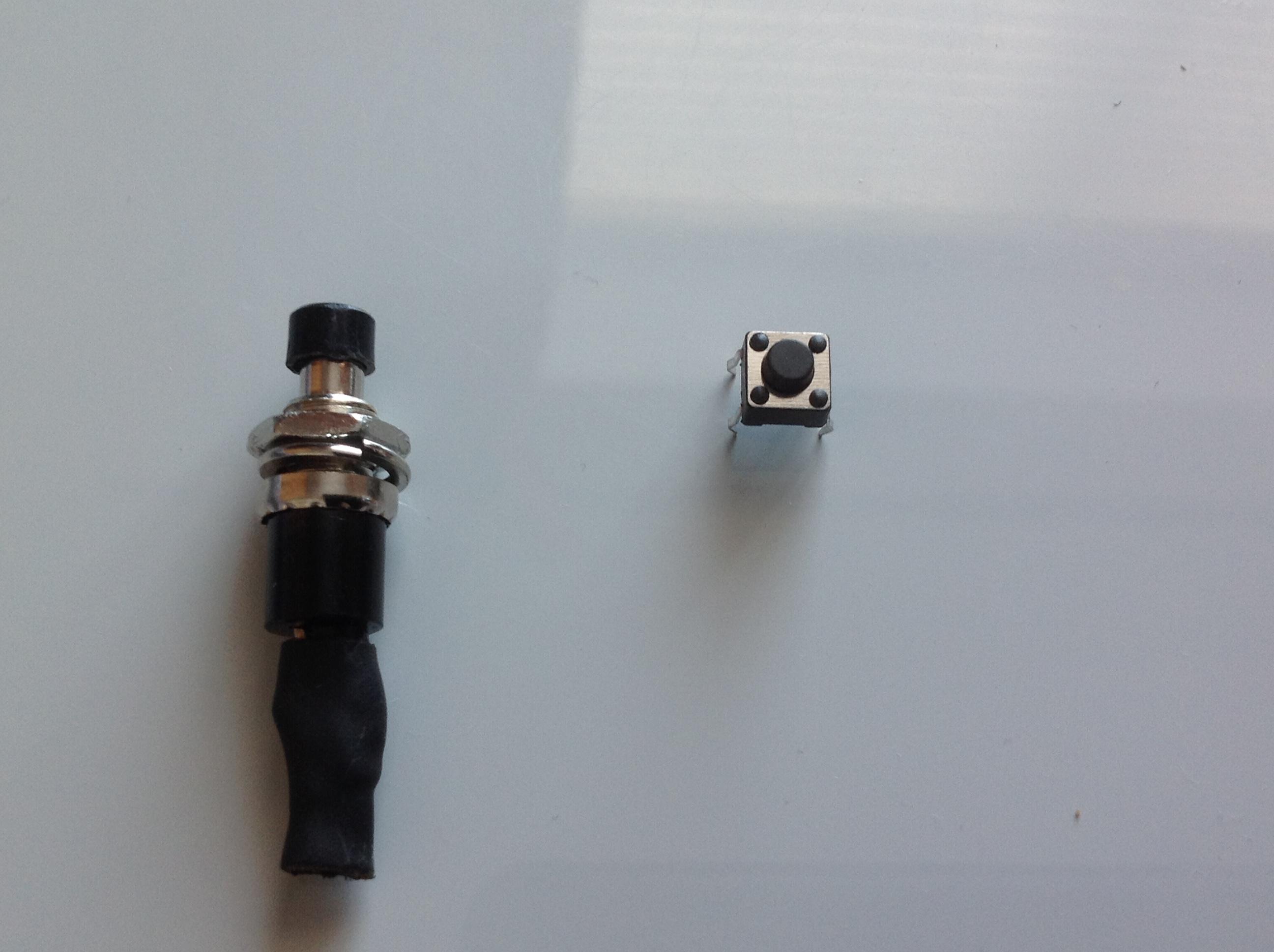

      While carrying out some testing of a wallbox2mp3 unit that I have recently built an installation for, it was apparent that when the cancell button was pressed that there was a problem.
      The set up is configured for & connected to my Wurlitzer 5250,  because I didn’t want to make any permanent modifications to the 5250 all of the required components are in a plastic adaptable box, this box is connected to the 5250 with 6 core telephone cable 3 core wires for 25vac ground & signal and 2 for a remote cancell switch that I had mounted to a  plate that I fabricated  & replace’s part of the slug rejector, so when the coin reject button was pressed the mechanism inside the 5250 pressed the remote cancel switch.
      I noted that the onboard cancel switch worked as it should so replace my remote switch with one of a different type so far this as worked without fault,  was curious if any one else had experienced anything like this.
      The photo below shows the two types of switch, the one on the left caused the fault and was replaced with one the same as the one on the right.
      Cheers Scudie

      Sooner
      Participant
      The switch on the left looks like the ones I’ve been getting off ebay. I’ve had problems with them too. Really flimsy design. I’ve screwed more than one while soldering the connections.

      Scudie
      Participant
      Hi Sooner
      I bought half a dozen from Maplins electronics here in the Uk when they were having a closing down sale.
      Not had any problems with soldering to them but it appeared it was causing an issue when operated, mostly cancelling multiple tracks when pressed and released.
      I wondered if it was cancelling one on the downward press and one on release?
      Ie not a clean on/off action thus causing the fault.
